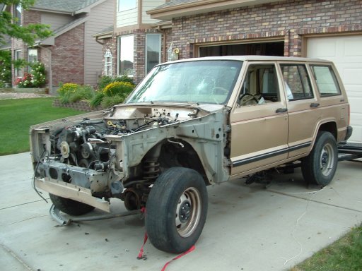

I have been modifying and building hot rods and off road vehicles for 50 years. One of my passions is keeping a 35 year old vehicle in like new conditions. That gets a bit hard when I have flipped and flopped it a few times. It has never been garaged so the cheap automotive paint rarely lasts more than 5 years. In fact I just spent the day sanding down the front clip in preparation to paint again.

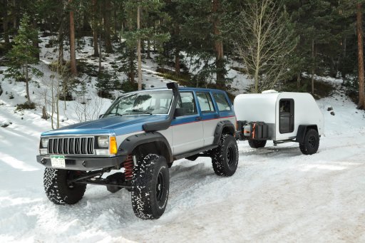

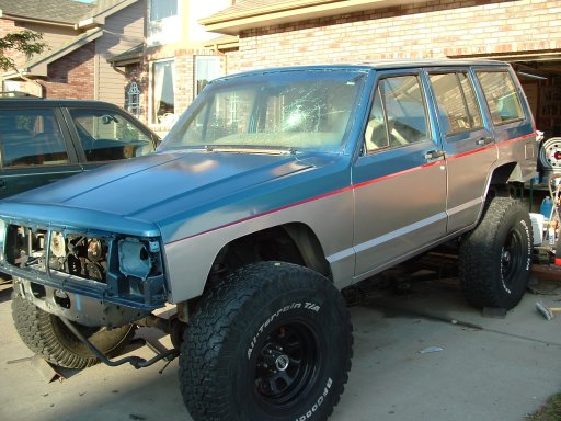

This is what I started with over 20 years ago.

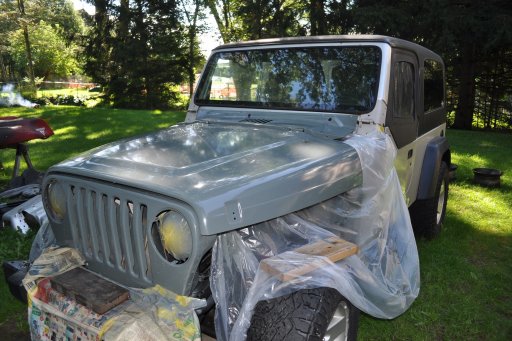

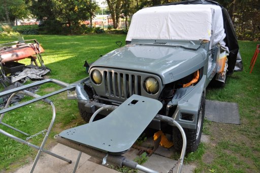

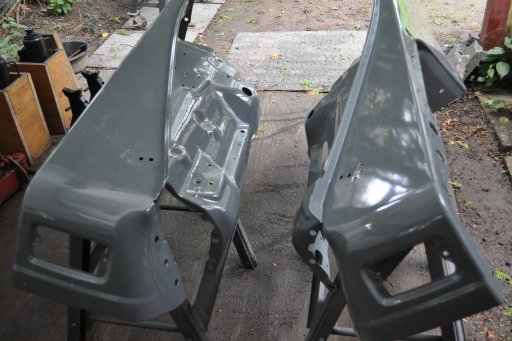

I'm currently painting my '04 Jeep LJ. I used to restore British sports cars, mainly MG's, and did a fair bit of painting. I stopped doing that in the mid-90's when my sons came along. Up to then I painted with Dupont Centari acrylic enamel. I am not up to date with current paints and I decided to keep things simple. I'm using Tremclad single stage enamel and cutting it with mineral spirits and adding a hardener (3:1:0.3). Tremclad is a Rustoleum product and has been around forever in Canada (not sure about the US). As far as I know it's the same as Rustoleum enamel.
About 3 years ago I had a local shop paint a pair of front fenders for the same vehicle. They did such a terrible job I decided to take up painting again. In fairness, they can't take the time to get into all of the "nooks and crannies" and still make a profit. Like anything, mechanical, fabrication, etc., if you did it in the first place it will be easy to to it again if you have to. If I decide to modify, replace, etc. anything on this Jeep I know I will be able to do it. If I scratch or damage it I will be able to fix it. I'm doing all of the work outdoors. I have a canopy beside my garage and that helps but weather is still an issue. In the end, I'll probably have 4 or 5 coats on this Jeep. I wet sand between coats and no doubt some areas will need some cutting and polishing. So far so good though. It's more than "presentable".
Last thing, I went with a colour change from Jeep's "Bright Silver" to Tremclad's "Gloss Grey" which I think is the same as Rustoleum's "Smoke Grey". This is straight off the shelf so no mixing. In the end, the only unpainted areas will be most of the fire wall and the floor boards under the carpets. I used the same paint and colour on my off road trailer so they should be a good match.

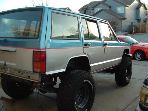

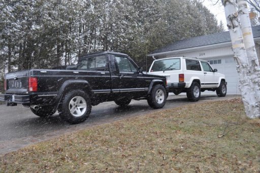

Mine too and that includes my XJ & MJ which run great. They look good too but who knows, I may paint them too one day. The MJ actually went through a colour change with a previous owner. It was originally "Colorado Red" but is now black. The shop did a good job with the door jambs, tailgate jambs, etc. but understandable did not do under the hood which is still red. I've changed under the hood colours of older, simpler cars, but that's going to be a bit of a challenge on this one.
I like your trailer which I know you built yourself!

So you did not cut that final grey with anything to spray it? That's an awesome job. It's probably the same way the guy who extended the rubicon my buddy has did his paint job. The smurficon.
Thanks! You'll like this ... I bought my main paint products at Canadian Tire. They are Tremclad enamel and Varsol. I had to go to Car Quest to get the hardener which is a Proform product specifically for enamel. I used 3 parts Tremclad, 1 part Varsol and 0.3 parts hardener. There are a lot of videos on YouTube where guys have tried various mixtures and this seems to be popular. It worked well for me.
We used to paint cars this way back in high school (late '60s) and it still works! :smiley:
Awesome. We may tackle painting the jeep again using the medium blue tremclad. That's what she is now. Thanks for the ratio sounds like a killer combo. Yours looks deadly!
