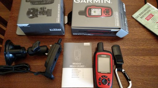

Most Hams use the 2 meters and 440 centemeter frequency ranges. Both of those are pretty much line of sight only. You would need a repeater in your area to reach out further, but that is still line of sight comms.
Pretty much the only route you have is with the Iridium satelite system. Which is basically a repeater at an extream altitude.
Garmin Inreach GPS has the ability to use the Iridium network. And it does cost.
If both users are out of cell range, then both users will need an Iridium capable device in order to communicate.
But if the receiver of the message is still in cell tower range, then they would not need an Iridium capable device.
I get my Inreach today if Mr Brown is running on time. :)
