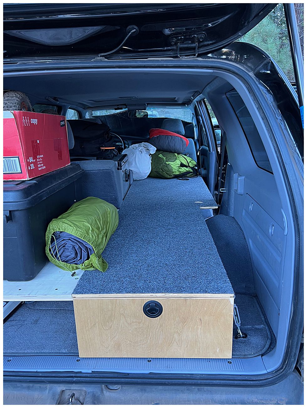

I made a drawer of sorts out of 1/2” plywood. Any suggestions on what to use as an anchor? I was originally thinking something like u bolts but not seeing anything short enough. Other basic anchors I’m seeing, I am not sure if screwing into 1/2” ply would provide enough holding strength? If going completely through, I also definitely want to minimize how much protrusion there is on the inside to avoid snagging anything
also - is there any meaningful difference in the placement of the anchor point? Bottom of the side? Top of the side? On the top plate?

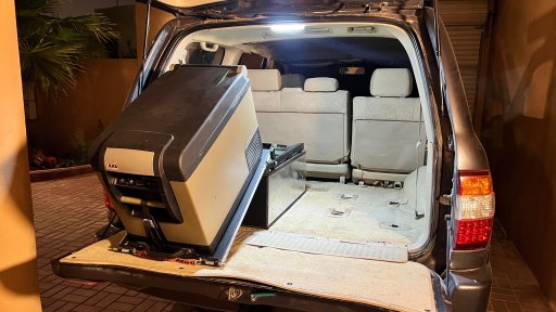

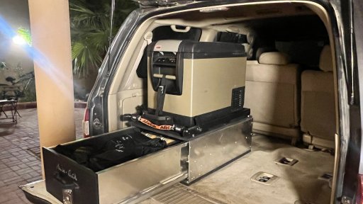

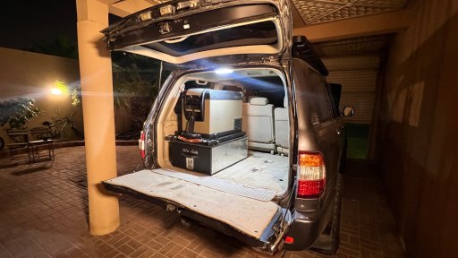

Hi. There are many ways to secure them. I instead removed the bolts from the tie down rings, found longer ones and secured a board by fixing it directly to the car using the same bolt location. Then I screwed the drawer directly on the fixed board. I am very happy with this solution.
