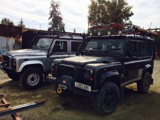

IMG_0850.JPG IMG_0845.JPG IMG_0846.JPG A friend asked me to assist resolving some issues on a Russian customers Defender 110 Double Cab. He had been to Germany and without any real research or thought booked his Defender in to get upgraded.
The job at first glance was looked great however I was asked to look at an issue with the Aux Battery going flat very quickly. Now admittedly the Defender is not a daily drive and sits for weeks at a time. But the Aux Battery was failing. The Russian was on his 3rd Aux Battery in less than 6 months when I looked at it.
First indications were the battery monitor was in alarm on the aux battery only and I measured it at 3 volts. Recovered the battery to 12.2 Volts and started troubleshooting. The wiring was not labelled with no information from the installer on what was feeding where and the connection on the positive terminal did not tighten fully and the crimps fell off.
Cables were run out of the seat box through holes that were not rubber grommeted. And switches in the rear were wired incorrectly so they permanently illuminated.
I have rewired the switches, resolved the rubber grommets issue to protect the cables and tidied up the seat box battery cabling to make it neater and easier to troubleshoot. So now I'm hopeful he will not have the same excessive drain on the Aux Battery.
