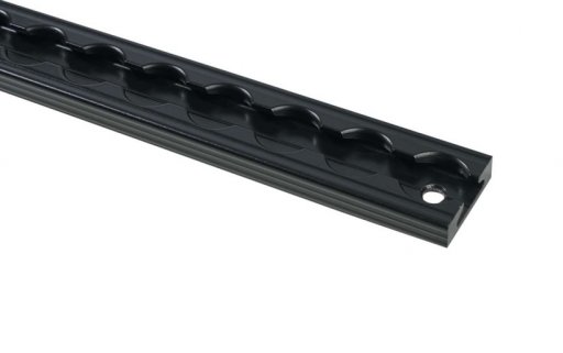

I have a question to those who have mounted airline rails on the outside of their rig. How does you fixed them ? I am thankfull for every tip. :)

Rivnuts is what I plan to run. You could do just a nut and bolt if you wanted to have someone hold the wrench underneith

Depends on the surface, mounting position and how stable it should be (purpose for the rails). Screwing through, riveting, gluing. I partially only riveted mine (bonnet and roof) and glued and riveted (on the side, e.g. for jerry can holders). Where would you like to mount them at your rig?
