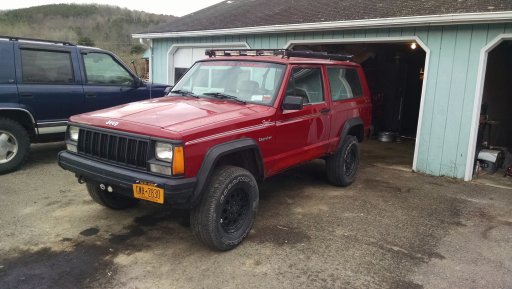

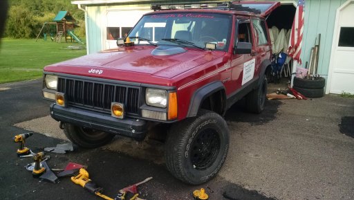

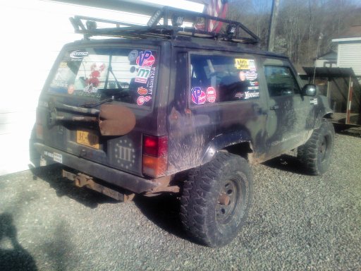

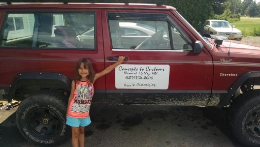

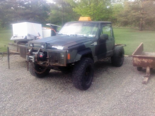

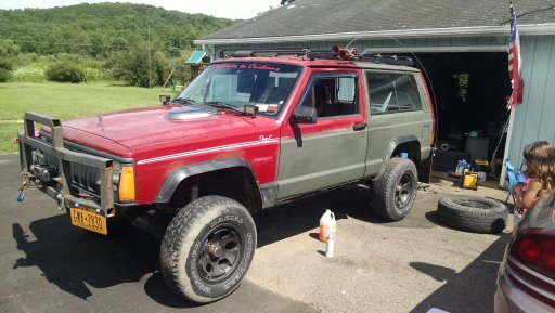

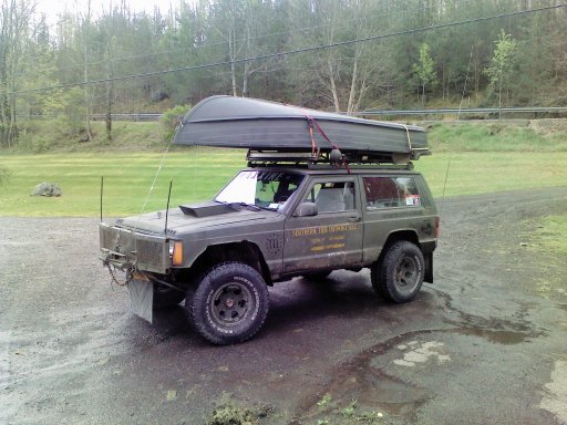

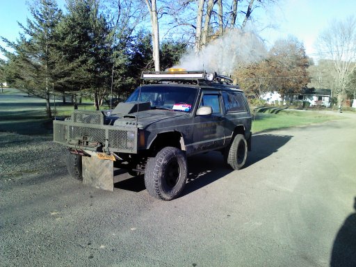

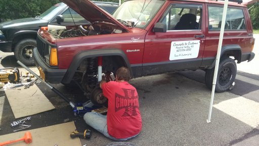

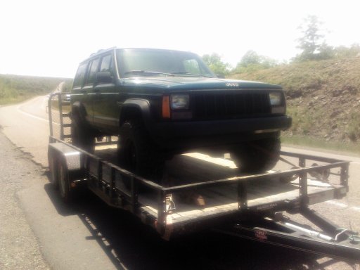

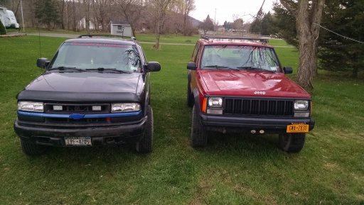

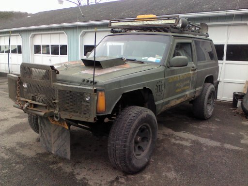

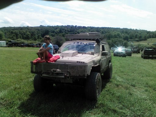

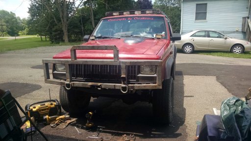

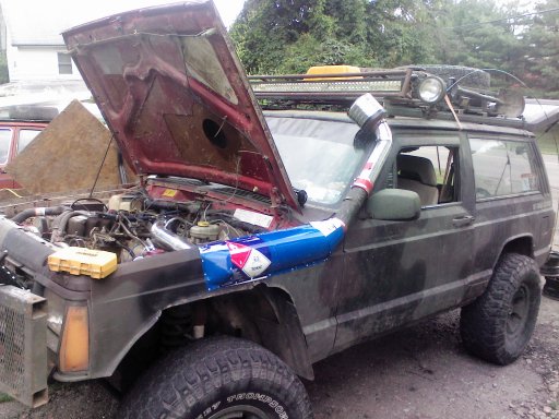

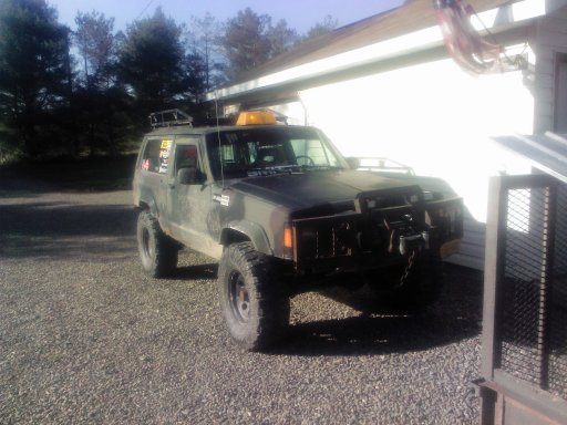

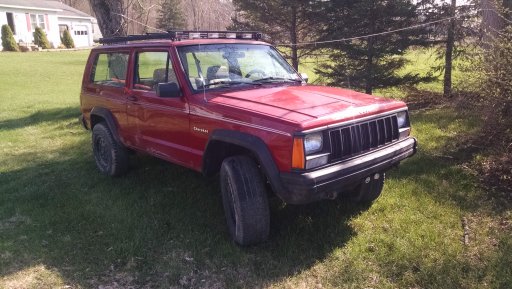

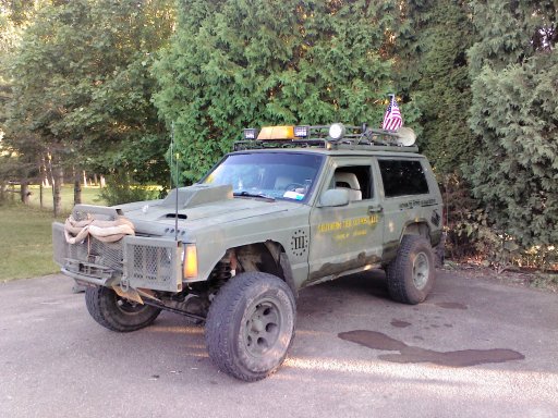

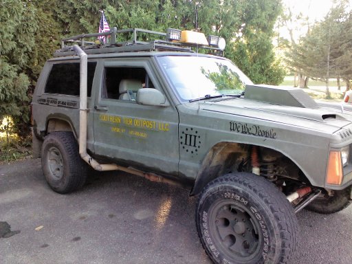

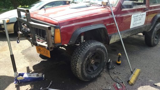

So let's take it back to the beginning. She started out just a craigslist jeep on a beat half assed lift (front only) and a broken coil spring. IMG_20150429_163948813.jpgIMG_20150501_165748262.jpgIMG_20150501_154921830.jpgIMG_20150808_145521614.jpgIMG_20150613_130642257.jpgIMG_20150613_162555471.jpgIMG_20150702_195102521.jpgIMG_20150711_125414218.jpgIMG_20150802_145843543.jpg
Then came the Zone Offroad 3" lift with shocks and a transfer case drop.
Then a bunch of random ideas... Paint, bumpers, lights, all the way out to Mad Max styling, thus giving her the name MAXXINE

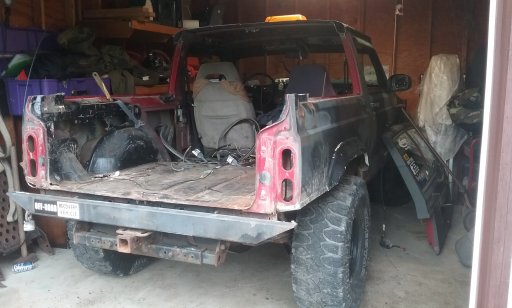

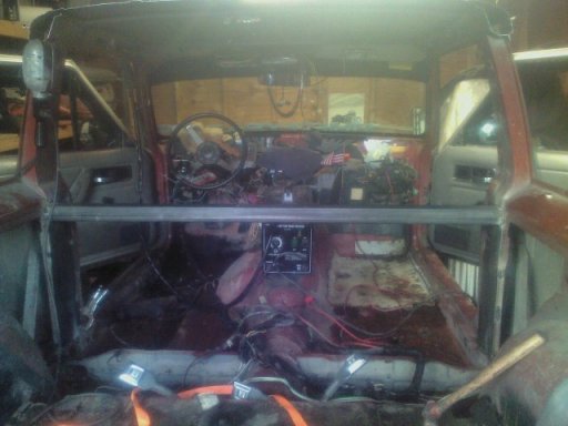

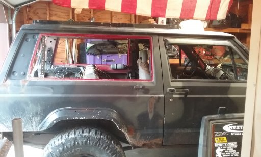

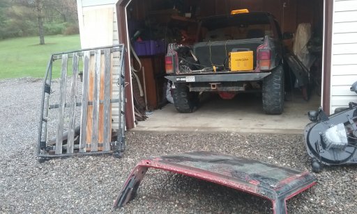

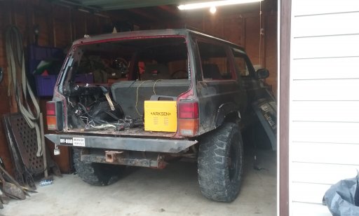

Been a bit, bought a house and haven't had much time. Not to mention I can't reply or post from home something's up with my browser.... Anyway, the chop process has begun.0502191759.jpg0502191755.jpg20190505_151901.jpg20190505_145952.jpg20190505_144046.jpg20190505_144017.jpg

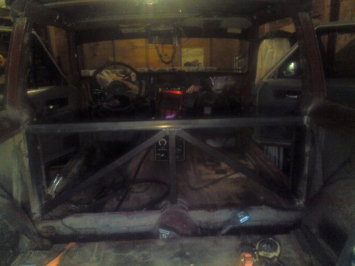

Got the main brace for the back wall in last night, next comes the temporary support braces so I can cut some more...0508191938.jpg

Small change in design, but more effective in the long term. Looks like the gas tank will be relocated, the unibody rails will be heavily reinforced, and the bed will be one of a kind. Here's the current progress. I only get a hour or two a day to work on it except the weekends. 0509191943.jpg

In a recent turn of events, poor ol Max is becoming a trail only rig. So much rot was hidden. On that note, here is her current state. My welder decided it dodn't want any more, so I'm waiting to buy a replacement, then I can resume the build. 6 years or better of hard use on a harbor freight welder ain't bad.0527191924.jpg

In a recent turn of events, poor ol Max is becoming a trail only rig. So much rot was hidden. On that note, here is her current state. My welder decided it dodn't want any more, so I'm waiting to buy a replacement, then I can resume the build. 6 years or better of hard use on a harbor freight welder ain't bad.View attachment 100999
If you're thinking of putting the bed that's to the right in the pic on the back of your XJ ... it's kind of small don't you think? lol. Seriously, a 2 dr. is the best XJ for a chop job in my opinion. I have a 2 dr. too and who knows, maybe one day ...
Although it would be interesting, no that won't be going on there. I'm actually in the process of figuring out placement of everything, as trail only rigs run by less rules a guess. The gas tank will be relocated, and I might finally carry a spare tire. I'll be eliminating many of the components needed for legal road driving, and making many changes to better negotiate trails. More pics to come.

Your rig looks fun! That's what it's all about. Your original snorkel intrigues me. I have one of those spectra cold air intakes. I'm not to keen on how chintzy the air filter actually is. I wonder if i incoporated it as a secondary filter to one coming through the snorkel like you had. I really want to free up the space for my Smitty built air compressor to power my arb lockers and tires. I think before I attempt it I will run my design through the mechanics at the Colorado clean air shop. Colorado has adopted California's laws. Which in Cali. The spectra cold air won't pass?????

My snorkel was actually piped straight to the intake. That filter was the only one lol. The cover for it was literally a coffee can. I now have it run across the engine bay and sit over the starter but right tight to the hood.
