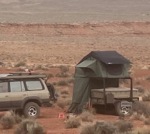

Finally lowered the tent and roof rack and strengthened it's connections to the trailer, added fenders and moved the spare to a rear mount.
It towed great from Houston to Ouray and back and handled the trail to Animas Forks great!
It was our first trip with a 1-yr old so we brought a large ground tent with a pack-n-play just in case and actually ended up using that when we camped and not the rooftop tent. Oh well. The extra storage of the trailer was well worth it!!
In the bins were: (1) Cooking, (2) Misc. Camp goods, (3) Sleeping bags & towels, (4) Boots, Jackets, and Bags.
In the rear bag which is one of those kinds you put on a hitch-mounted rack were our camping chairs, pack-n-play, pop-up play pin (bigger than a pack-n-play), EZ-up Coleman tent, and play-mat.
There is no way we could have fit all of this gear in or on the Jeep and we used all of it!

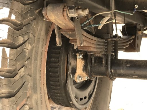

I’ll be getting to this point in my build here soon! I’ve seen a few people have issues with trailer bounce, let us know if you end up with any issues. Looks great so far, appreciate you sharing!
I guess its been enough time to comment on this topic. Trailer bounce is definitely noticeable when empty. However, when we have it fully loaded, it's fairly planted.
Low tire pressure is quite helpful too. I run them in the high 20s usually which absorbs a lot of the bumps.
I do want to revise the suspension and axle though. I'd like to swap to a straight axle with less capacity leaf springs and add some simple shocks. That ought to make it ride much smooth.
I'm not sure if I have commented on this, however, I am running 285/75/16s, matching my tow vehicle size, with about 22 psi. Trailer is never empty only +/- 250lbs of H20. You are thinking less capacity leaf springs. I think the stock slipper springs are rated at 2,000 lbs . I went up to 3500 lb double eye springs to match the swapped in axle rating. One of those snapped in half, ( see below ). so I went up to a 5 leaf giving me a 5800 lb capacity. The stock shackles shattered, so I stepped up to a 7,500 lb shackle. Just a thought DSC00436.jpg
I think your experience makes sense here but I wonder if there is more going on regarding the spring breaking in half. From my understanding, it is one of, if not, 'the' weak point of the spring. I remember you saying you heavily use your trailer off road. I wonder how much fatigue the spring took before failure and if any corrosion or manufacturing defects played a role.
I'm merely wanting to decrease the overall stiffness of the spring and allow it to do a little more flexing. I do know this will decrease its life since It'd be more fatigue stress but I think for most highway and very mild off road adventures, it should suffice. That being said, you have a good point about going even lower on the tire pressure to dampen the system. I like that free solution!
Reactions: MOAK
I think it is simple physics, if a spring is rated at, we’ll round it for simplification, 1,000 lbs and the trailer weighs 1200 lbs, in theory, two springs should have no problem and on regular maintained roads it isn’t a problem. But unmaintained roads? At any given time all the weight can be smashing down on one side or the other. Suddenly we’re asking a 1,000 lb spring to not only support 1200 lbs, but we’re asking it to support that weight as it comes smashing down. It could easily be double the 1200 lbs. Way back when, interstate highway budgets were slashed. As a result during the late 80s and early 90s interstate highways in the east were abysmal. Breaking leaf springs on the trailers of big trucks happened all the time. In short, the springs were fine and barely broken in. I was asking them to do something they were not designed to do.
I apologize for not responding to this sooner.
Added mass is definitely a large force. Much of my work is in rigging design and analyses of subsea structure installation. So, like you, I'm a big believer in shock loading and dynamic forces. That being said I imagine the weight ratings of leaf springs are for static loads and not dynamic. I'm not a steel design engineer but from what I've gathered, a 2.5+ FOS is used on leaf springs to account for dynamics.
All that aside, I think you're right that the design intent is for highway use with little fatigue and stress. I've only done one short trail with my trailer and I can attest that the springs have to respond to much more load variation in 10-ft of trail than they do in many miles of highway.

good question, i'm not sure how much it would prolong the life, but i imagine slowing down the spring fluctuations between compression and rebound would be kinder on the springs. my main intention with the shocks would be to smooth out the ride on the trailer. i notice my trailer rides decently when i have a little bit of weight over the axles and a a little on the forward end of the trailer. it still bounces, but is not as bad. with only a little weight or no weight, it gets really bouncy. for the price and the ease of install, i think its a worthy addition to a basic leaf spring set up.
Agree on the shocks, I’ll install a pair on our trailer before our Arctic/Yukon run next summer. Interestingly our trailer doesn’t bounce much at all on highway, but even at a crawl it is constanty finding air underneath one tire or the other, at 20Ppsi.
