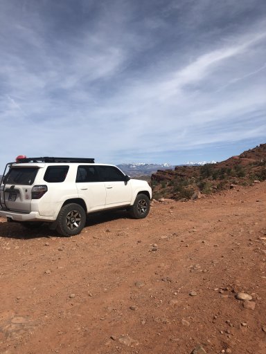

A190466A-DA04-463A-832E-01AD3A7FC598.jpeg I’m running BFG KO2’s in 265/70/17 on trail edition wheels on my stock SR5P and couldn’t be happier. I’ve been all over Moab and Colorado and they have functioned flawlessly off/on-road.

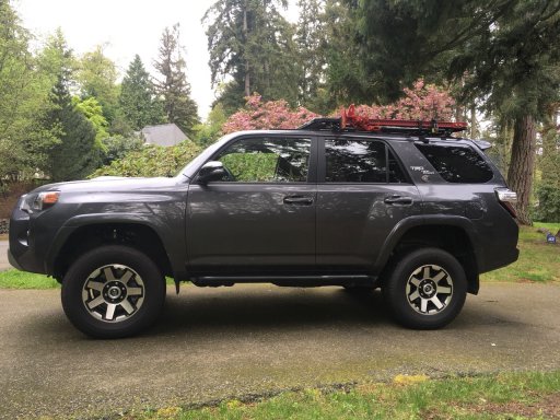

Tires are in and install / alignment is going down on Thursday morning. I will reply with pics and report then. Here is the rig with the lift and stock tires.IMG_1608.JPG

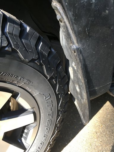

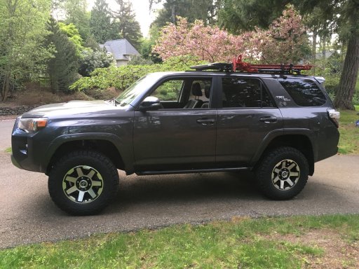

Today was the day, tires and alignment complete. Big thanks to the folks at Tru-Line in Bellevue WA for making it happen. I also had spiderco 1.25 in spacer/adapters installed. As I previously noted I went with BFG KO2 275/70/17 and it rubs only on the driver side front. The rub is both on the mud guard and the front fender at the bottom of the wheel well when turning. I removed the mud guards on the front and it still rubs a tiny bit on the body mount ( not enough to change anything) as for the front of the wheel well, I will trim it with the Dremel and that should cure the issue. Everything else is fine. Funny (but understandable) that there is a difference between the front driver and passenger. Here are the pics to prove it. Hope this helps in your decision making. I am so stoked to get out on the trail. 20180503_235537564_iOS.jpg 20180504_024202531_iOS.jpg
