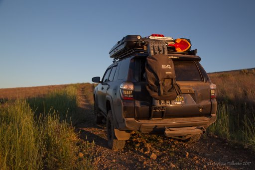

Another KDSS fan here. Better handling on and off-road. I have a Stage 2 Icon upgraded suspension and have had no issues.
KDSS and XREAS are two different animals. With XREAS you were stuck with the factory suspension until you ripped it out. Having said that, my 2006 Sport Edition w/XREAS is still rolling around town with over 200,000 miles on it with its new family. They love it...
The prototype TRD Pro was originally built on a Trail Edition platform with KDSS. Costs cut the KDSS from the Pro, not performance.
As an ex-sportscar racer, I'd say this pig handles pretty good in the twisty bits for as much crap as I carry. Corners fairly flat with little body roll. Of course, I understand its limitations and drive it accordingly.
