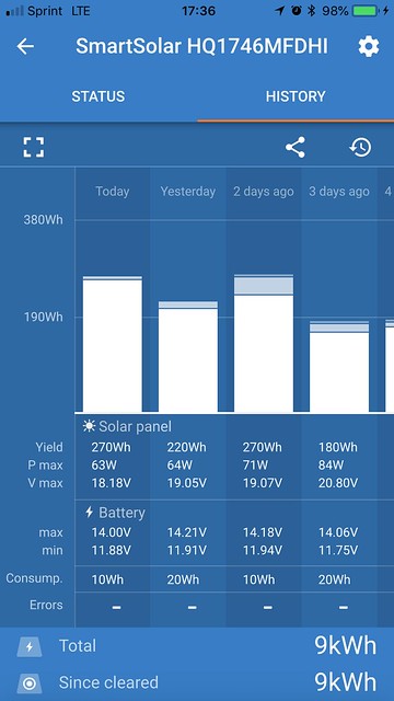

I was very aware of my ARB 50qt's draw on my stock single battery, but I didn't have anything else tipping me past the point of requiring the weight of an entire second battery. I went with an 80w high efficiency solar panel with a very efficient MPPT charge controller. The setup weighs significantly less than a second battery, and extends my time I can be parked without having to run the vehicle. The panel generally bulk fills the battery and by the time I leave work my alt is just topping it off.
Solar Monitor by Erik, on Flickr
