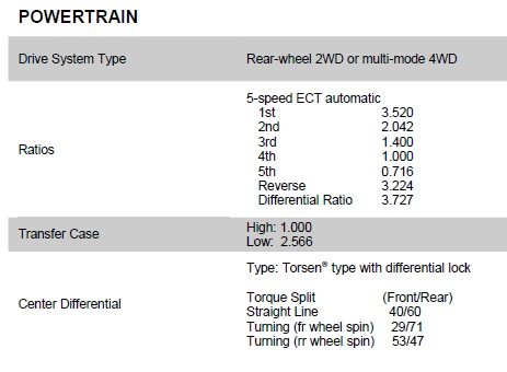

The models with manual transfer case and manual shifter do not have a center diff. Old school type transfer case without a viscous coupling. The models with the electronic transfer cases using buttons and knobs for switching have the center diff. I may be wrong but I believe all 4th gen had an electronic transfer case and the manual shifted are in Some models of the 5th gen. I am not included 1st through 3rd gens as we are only talking 4th and 5th gen. The center diff lock button looks like below. Also note placing an electronic transfer case in 4LO automatically locked the center diff, even without pushing the center diff button. I admit I kinda miss my 4th gen in the respect I had 2wd, all wheel drive, 4HI with center diff locked, and 4LO with center diff locked. And the reason I miss it is I have 5th gen limited which is only 5th gen model without 2wd. IMG_1217.JPG
Reactions: VCeXpedition
hookem11
The models with manual transfer case and manual shifter do not have a center diff. Old school type transfer case without a viscous coupling. The models with the electronic transfer cases using buttons and knobs for switching have the center diff. I may be wrong but I believe all 4th gen had an electronic transfer case and the manual shifted are in Some models of the 5th gen. I am not included 1st through 3rd gens as we are only talking 4th and 5th gen. The center diff lock button looks like below. Also note placing an electronic transfer case in 4LO automatically locked the center diff, even without pushing the center diff button. I admit I kinda miss my 4th gen in the respect I had 2wd, all wheel drive, 4HI with center diff locked, and 4LO with center diff locked. And the reason I miss it is I have 5th gen limited which is only 5th gen model without 2wd. View attachment 86700
Exactly right. One clarification on the center diff lock: the lock button in your photo can be pressed (or not) in either 4LO or 4HI. So the 4th Gen T4R can run in 4LO unlocked (that's the default) but can also run with the diff locked in either 4LO or 4HI. On the V6 you can also run 2WD (obviously diff lock unavailable in that mode).
