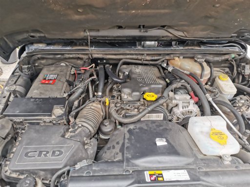

Jeep ran Isuzu diesels, I thought the CRDs were Benzos?Since you asked for participating, I leave you a picture of my 2012 jeep JKU diesel LHD it's a 2.8L common rail and a close relative to what is known as a 2.8 duramax in northern America.
Feel free to ask
And yes it's not fun to work on...

They should have stayed with Isuzu... Yes there where Mercedes diesels, I believe in the WJ and KJ, after that it's VM Motori but they kept the WA580 nag1 transmissionJeep ran Isuzu diesels, I thought the CRDs were Benzos?
