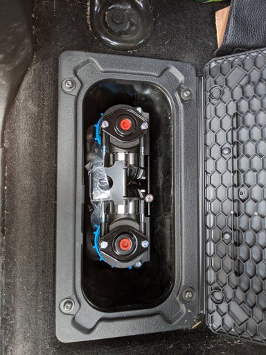

Thanks, that would be appreciated. I've looked on the other side and I'm pretty sure I have absolutely no room because of my air box. Maybe since your PW is newer, it's designed differently and the tray will fit on the passenger side. The washer fluid resevoir comes off the fire wall a bit on that side on mine. Which decreases the space I have.
Off topic to another question. I've bought the ARB dual compressor. Been under, on top and all over the truck trying to locate a good mounting area. I'm leaning towards taking the drivers side fender off. Then mounting it where there seems to be enough space. Hopefully it will work. I like having it right next to the battery. Will you be adding a compressor for tire deflate/inflate? Just currious and wanted to hear your idea, if you had one. Thanks again for the response. Looking to forward to sseing your dual battery build.

I scrolled for DAYS to find you this picture :)
That is where I ended up putting mine in my Ram 1500. I had to put a right angle fitting on the output then ran it to a tube with a quick disconnect. This allowed me to run the tube out and still keep the quick disconnect. The downside of putting it here is that if you fold the back seats flat and then stack stuff on top it's kind of a pain to get to. Or if you have kids like me to get them to move their feet :). You simply drill through the bottom of the plastic insert and run the cable to the engine bay from there. I would do that again in the 2500 with the exception that I just bought this:
The reason I went that route is I like the idea of the tank and being able to run power tools. The REAL reason is I am super lazy and my wife has a Lexus GX and I didn't want to install two air compressors :)
