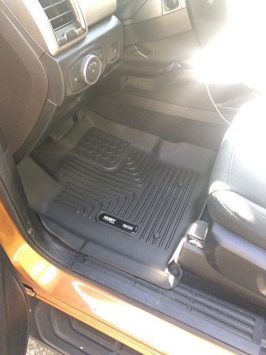

Next thing I needed to do was replace the front floor mats with floor liners. I went with the Husky X-Act Contours.

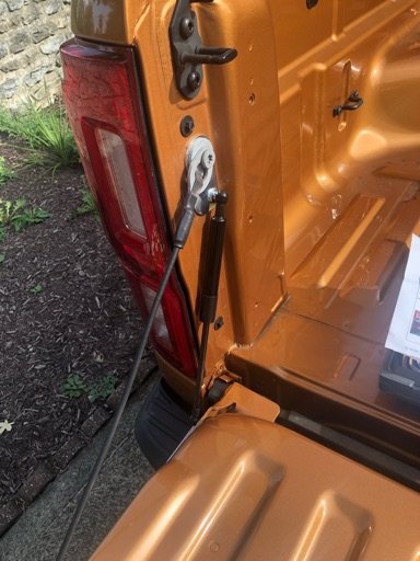

I hate how the tailgate just drops open so I put a dampener on and it is so far my favorite addition

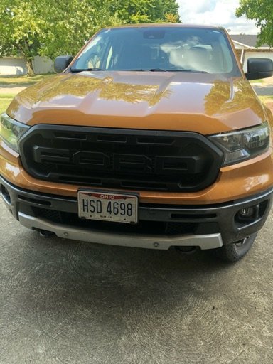

I wanted to give it a little more aggressive look so I installed the raptor grill with amber lights. Not sure if I like it though.

Not a fan of the way "ford" sits on the grill. To bold maybe? I'd black out the original logo. I prefer the original grill.
Nice looking truck though. Cool colour
Yeah, I think you're right about that grill. I will probably end up going back to stock and maybe getting the blacked out Ford badge. I might try to swap the amber lights over though.

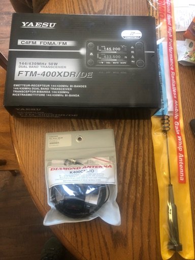

Was kicking around a few different routes to go with the bed and landed on the softtopper.
As for the radio I haven’t got it installed yet. Finding a grommet has been a pain but once I found one I don’t have enough cable on the antenna mount so waiting for a extension to show up. Also if anyone has any suggestions on installing/routing the radio and antenna I'm all ears.

There are two a/c exhaust vents on the back of the cab. I ran mine out there and up to the top. If you go this route leave a loop of the cable going down on the outside of the vent so that water doesn't follow it in.

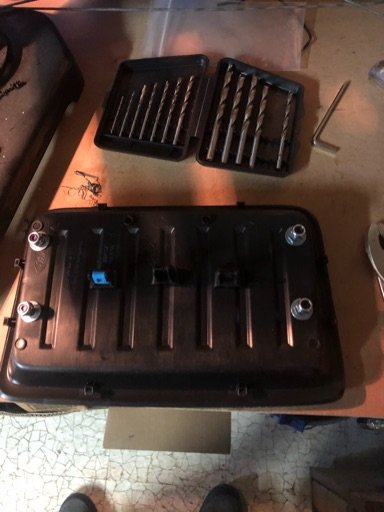

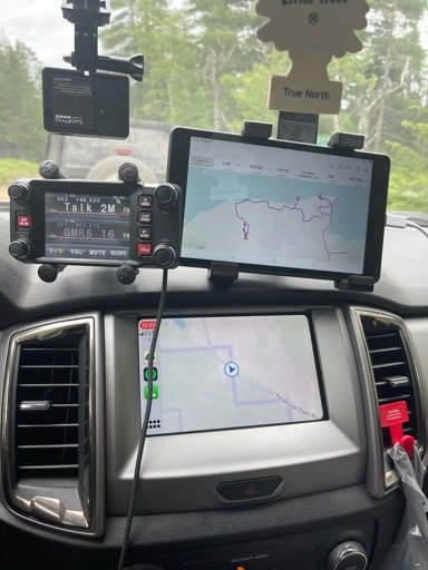

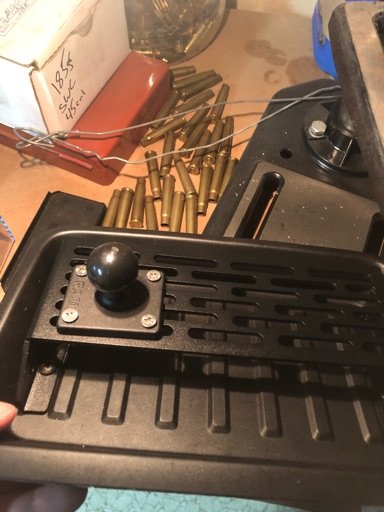

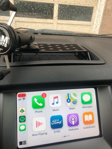

Finally got the Yaesu Ftm400 in the truck a few months ago. I punched through the rubber surrounding the wire loom behind the break pedal. For the handset I opted to try using a Niteize Steelie ball which I highly recommend. For the head unit just have it in the Ram X
