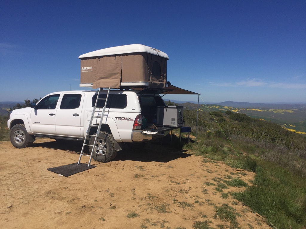

I have an autohome airtop rtt on a Yakima rack mounted to a snugtop rebel Sportsmans edition. The Sportsmans edition has a double thick roof with a 500lb capacity. It's worked great over the last two years.

Yes I did have to order mine. Fortunately they build them a few hours from me so I think I only had to wait about 2-3 weeks for mine. I got the optional electric lock that works off the factory key fob and is worth every penny, the Yakima rack that is good enough, and fold down front window for cleaning which I have never used. I think it was $3,400 with a small military discount. In hindsight I wish I would have got at least one windoor on the passenger side where my awning is and eventually I might add one. I am very pleased overall. The airtop rtt is probably about 150lbs with my bedding, I weigh about 260-275 that with my wife puts the weight a little over 500lbs and it has shown no signs of fatigue over the last couple years. I am going to add the total chaos bedside braces just to be on the safe side.
