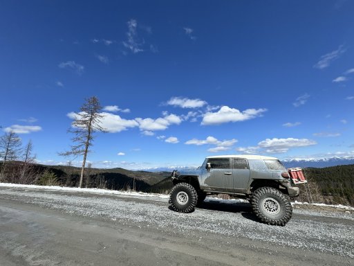

I haven’t been on for a while and I’m getting ready to start phase 2 on my sas Fj. figured I did a poor job of documenting its build up to this point I’d do better at this revision of my Fj.
so far the following has been done .2013 Fj auto
3 linked front rear
05+super duty Dana 60 built rcv arb lockers 4.88
14bolt ff rear arbs locker mw shafts and flanges 4.88
16” king coils valves for the Fj
17 kmc 43s MT bajas
I built it for snow wheeling but find my self driving it more and more to town so I’m going to be redoing a few thing for more overlanding snow wheeler. currently installing a atlas 4 speed and redoing the front suspension to lower the truck 2-3”
3 linked front rear
17 kmc 43s MT bajas
