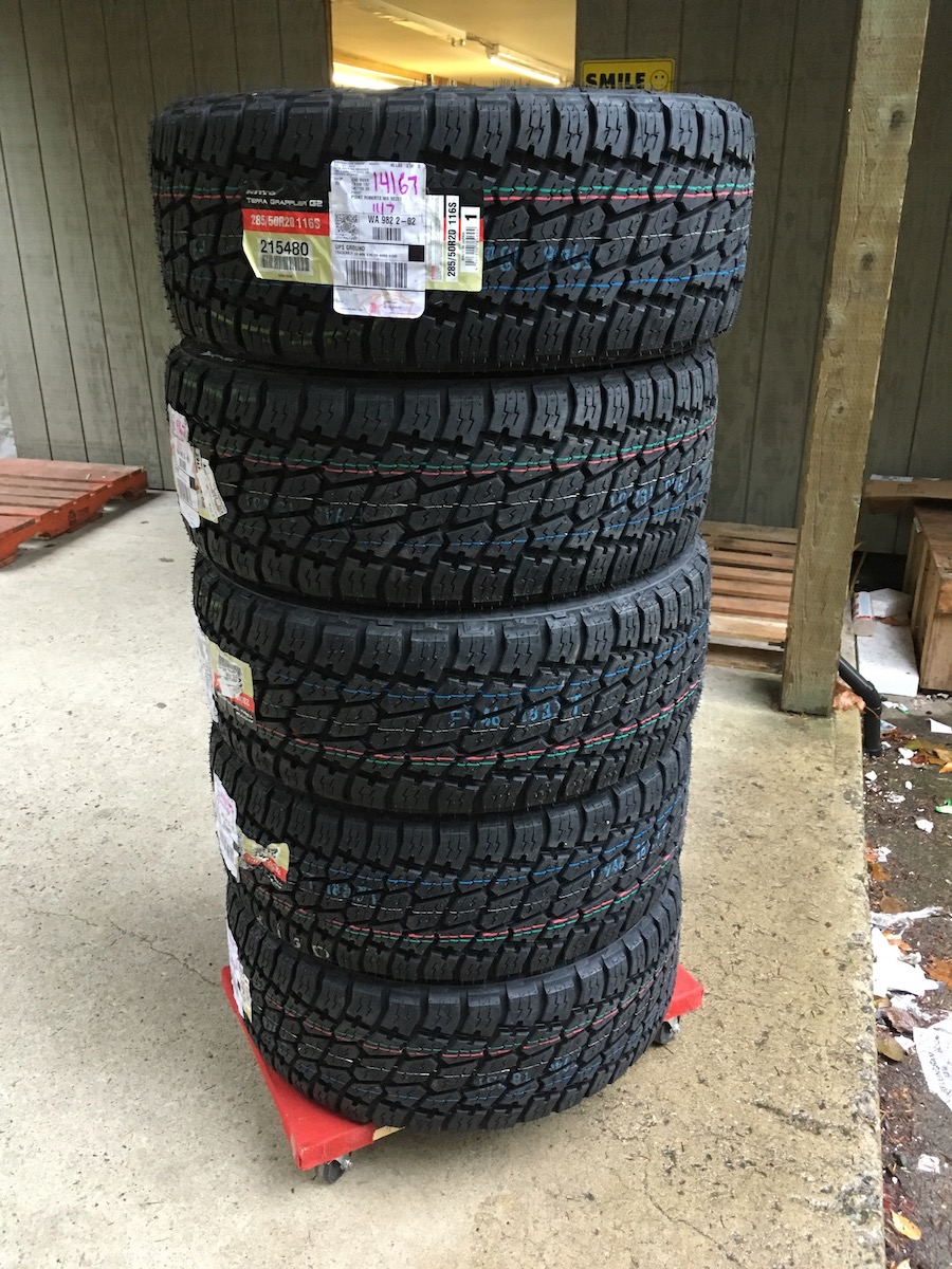

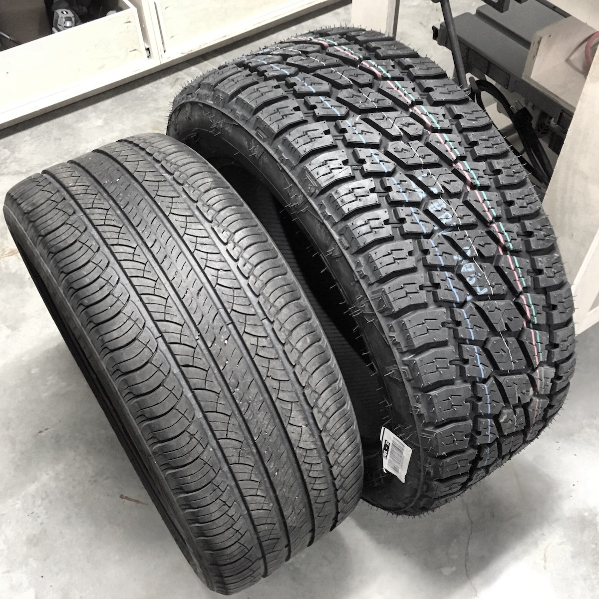

I ordered tires (Nitto Terra Grappler G2 285/50R20, should be about 31.5") for the stock 20" wheels. Nittos are new to me, I had Cooper Zeon LTZs on the Evoque and they got crazy loud after about 20K. I'd like some input, but from what I've read going for > 32" tires on a Supercharged is a major hassle (new brakes, new wheels, lots of trimming).

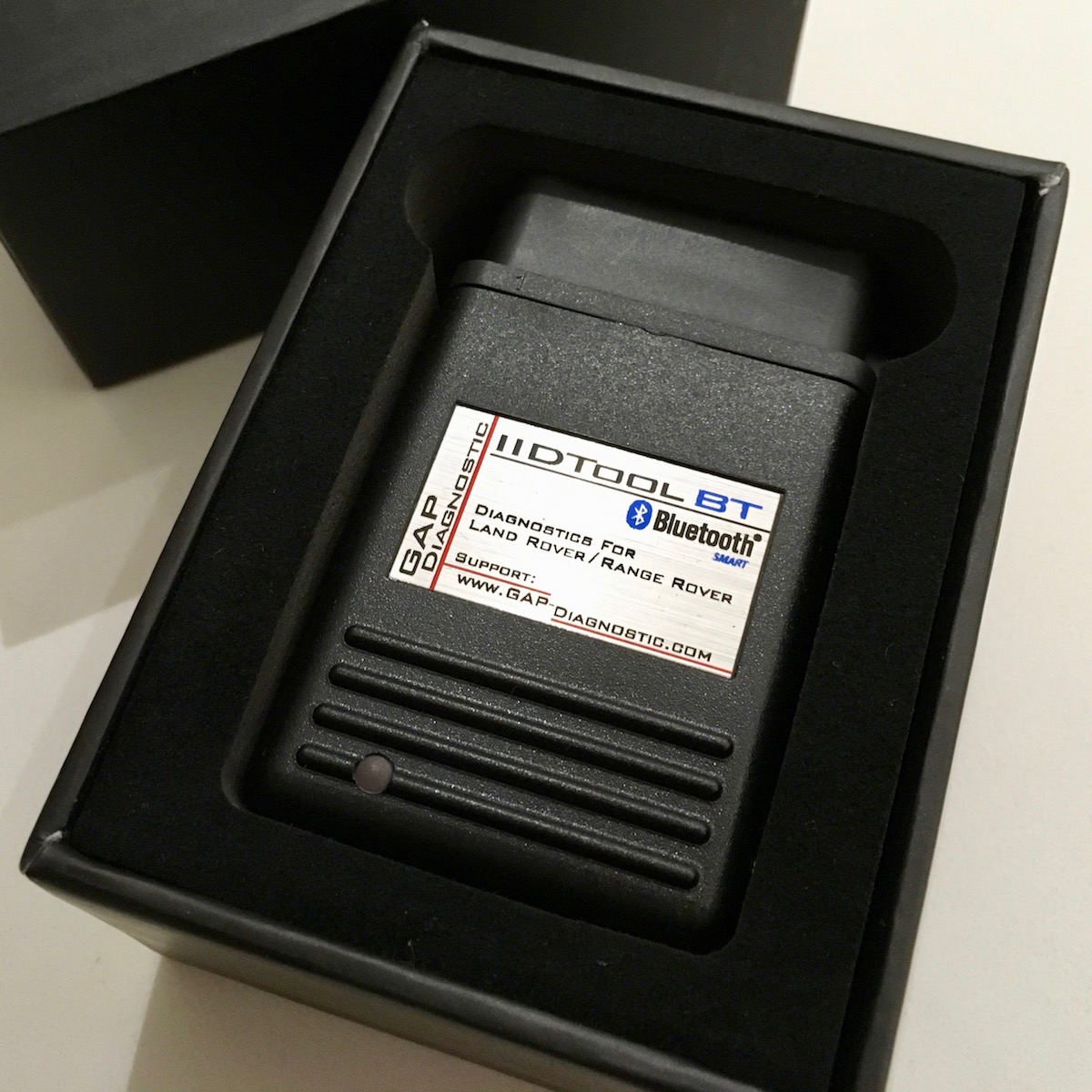

I've also received my IIDTool in the mail.

We had the nittos on my wife’s LR4 and got 62,000 miles on them. They did quite well in that time. Finally their real weakness showed as the side wall is short because of the 20inch rims and I got a sidewall puncture. But that was at 62,000 miles. They handled the off road stuff fine. Snow, mud, rocks, etc. Stayed pretty quiet the whole time. Just swapped to compo wheels and BFG KO2’s which are very quiet. Haven’t had the chance to take them off road but except them to be superior to the nittos as I used to run them on a pathfinder. Only swapped because the LR4 is becoming the family off roader and less of my wife’s daily driver.

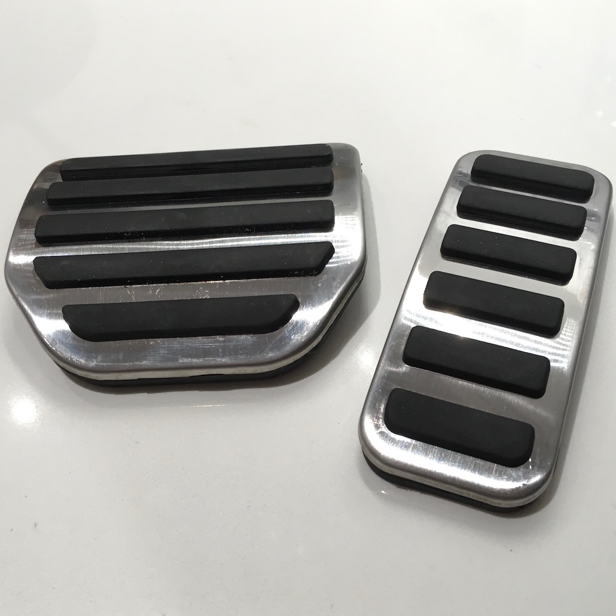

Tires showed up, they're going on Saturday morning. I've done a few really minor tweaks: interior LEDs, stainless pedal covers, and removed the very weathered RANGE ROVER and SPORT badges from the tailgate while I wait for new ones.
