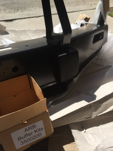

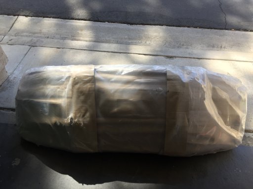

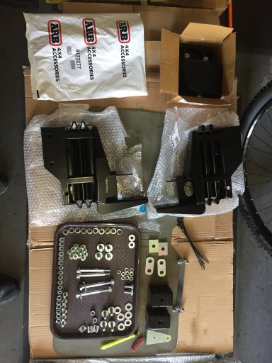

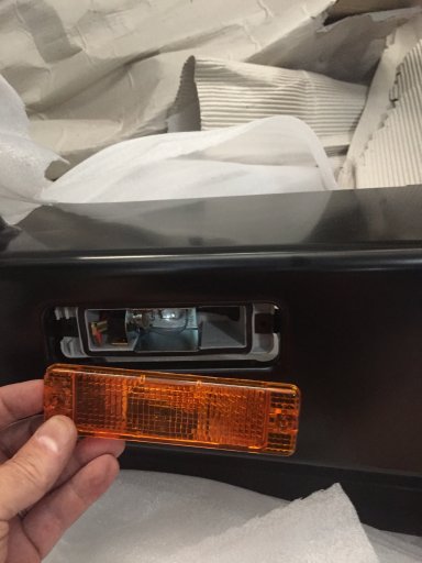

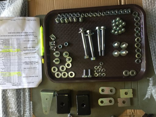

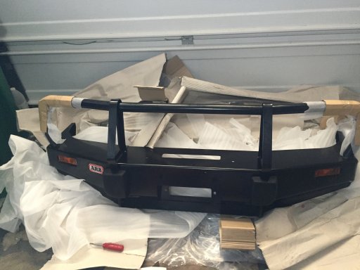

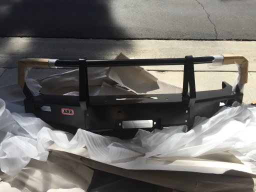

Now the bull bar should look like this. The easy part is over now you have to sort through this bag of bolts and figure what matches the install document.IMG_0083.JPGIMG_0048.JPGIMG_0044.JPGIMG_0049.JPG

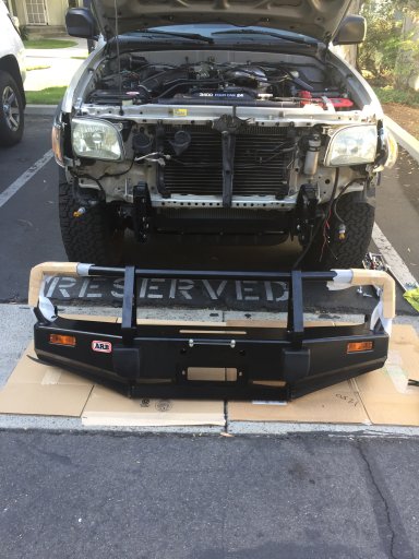

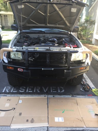

Remove old bumper, this is fairly easy. I didn't take pictures of this because I encountered a stripped bolt in one of the bumper crash cans that I had to drill out to remove.IMG_0050.JPGIMG_0084.JPG

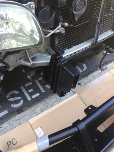

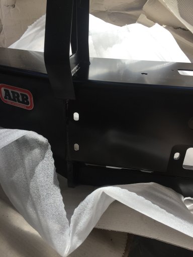

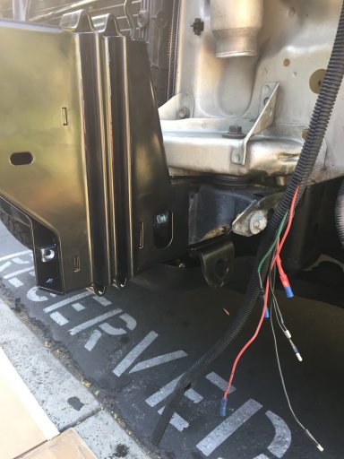

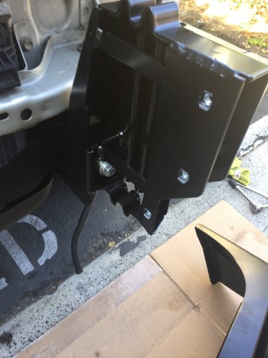

Once you have the bumper off it helps to understand how this is going to be mounted. The instruction are very weak and could use an expanded view of how the brackets and hardware are supposed to be installed.IMG_0085.JPGIMG_0086.JPGIMG_0088.JPGIMG_0089.JPG

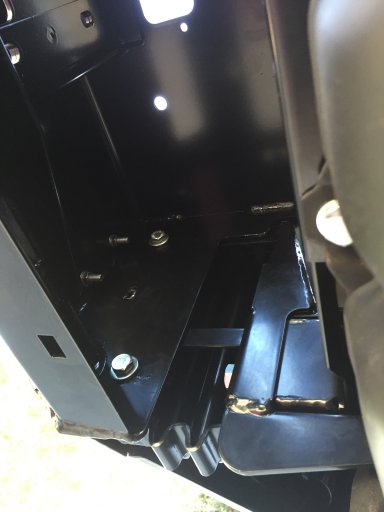

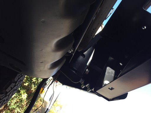

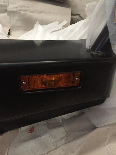

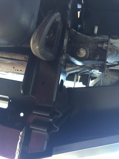

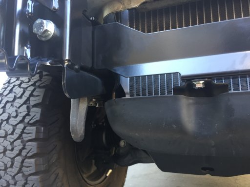

Once you get the bumper brackets installed, you can install the bumper and check fit, you don't need to remove grill. I was going to black it out with bed liner paint to match the fender flares. I tried to take some pictures of how the bumper attaches to the brackets.IMG_0091.JPGIMG_0095.JPGIMG_0097.JPGIMG_0096.JPG

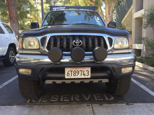

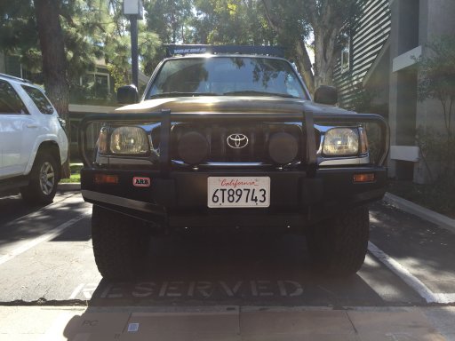

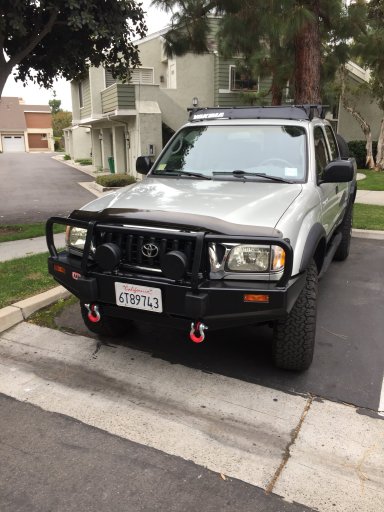

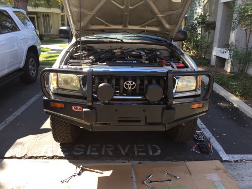

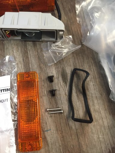

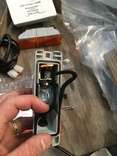

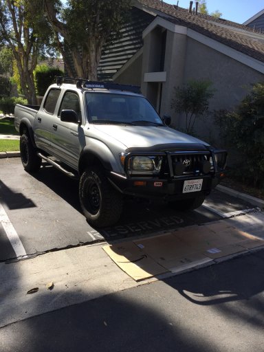

Here is the finished install with KC lights added and the before and after. I don't have a winch yet so at some point in time I will be taking it off for that project.IMG_0109.JPGIMG_0110.JPGIMG_0114.JPGIMG_0050.JPG

Lacking was an expanded view of the parts and part numbers for the installation process.
