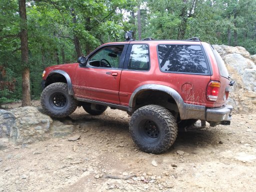

I got this truck stock and have been wheeling in it for 5 years now, and have been very satisfied with its performance before and after modifications. Mods are many, but the important stuff is this:
Front: 4" Ranger Superlift + 1" RTZ torsion keys
Rear: OME 1.5" lifted springs (non-standard) + 2" RTZ shackles
5.13 gears
33x12.50 Nitto Trail Grapplers on 15x10 Pro Comp 51 Series
Long live the 2-door!

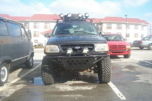

@Grit City Paul Nice rig, guy! Fabrication and Ford Explorers go together like ham and cheese. I've got some sort of a similar-ish bumper setup in my plans, but will focus more on the lower portion than the upper. Think something like yours, but... upside-down? The "stinger" would go underneath the bumper and connect to the hitch receiver brackets and probably bolt onto the crossmember behind it for extra support and a skid plate. Something akin to this, but I'd keep the fog lights under the bumper as well.

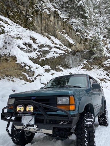

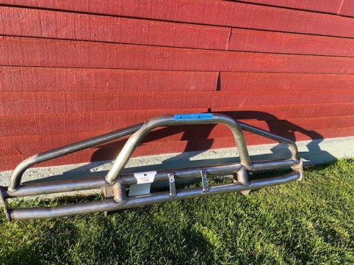

My front bumper is one of the few parts manufactured for the Explorer. It's a James Duff bumper, but the non-winch style that I fabbed for a winch. . .

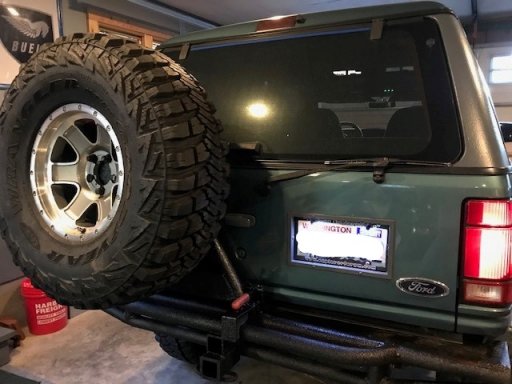

Almost everything else, however. . .

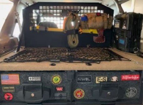

and. . .

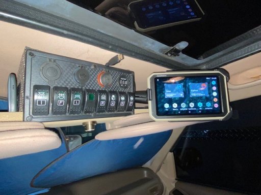

or. . .

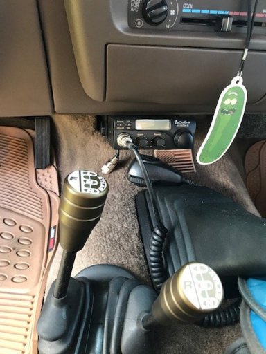

etc., etc.
Save the 2-Doors ! ! ! Save the Manuals ! ! !

@Grit City Paul Nice and clean. Some rigs have stuff just all over the place, blocking the view from the driver's seat. You've got good taste. I'd like some kind of partition or cage for mine, but it has to allow for my spare tire to sit in the back! Sadly nothing except my tire is actually mounted, so a rollover would cause flying objects. Gotta figure something out!

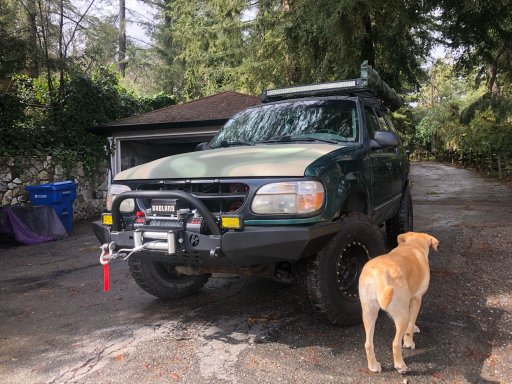

New member here with a 99 Explorer XLT 4X4 4.0 SOHC & 5R55E trans. Bought new and converted it from grocery getter / Kid taxi to an over lander over the past few Years.Although not a rough terrain rig by any stretch and virtually no aftermarket the body on frame and reliability make it a good platform. 2” lift with 31” Dick Cepek tires on faux bead lock steel wheels. Still a work in progress but it gets me out there and back. Glad to know more 2nd gen’s are out and about.

@Michael_a8fbc4 Nice rig! That bumper looks pretty solid. In all honesty the Explorer is best when left at 2-3" (no drop brackets or such, just re-indexed torsion bar keys will do) and 31" tires. That's about as far as you'd want to take the factory gears, even if you have the 4.10's.
Beyond that, there come issues of clearance and torque and it just goes on and gets worse from there. You're on the right track with yours. Keep it simple and use it well. If I had to start over, I'd go about 2" lift and 31's.
I don't regret it a bit, though. It is FUN to drive that sucker, but regearing to 5.13's means I can never run less than 33's ever again.
