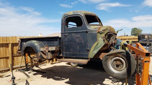

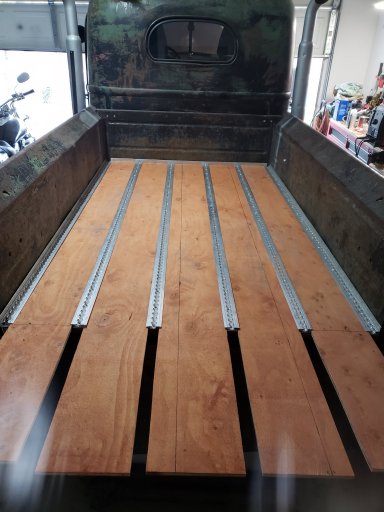

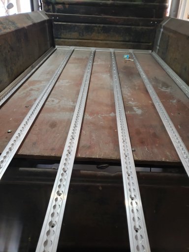

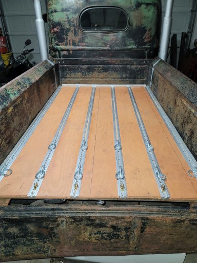

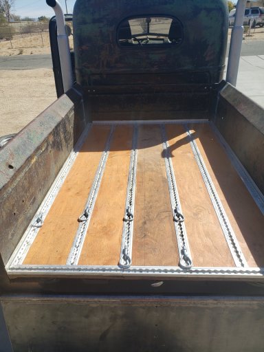

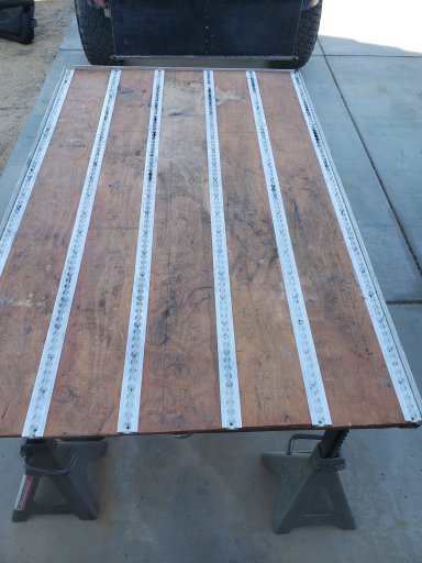

This bed mount redo is taking me way longer than I thought. I was like 3 days at most. 1 day to build, add the square tubing, another to make the bottom tube mounts and the last day to create the frame brackets. This has taken me over 5 days to complete. I don't know if I am just getting old or just getting distracted. I guess it takes longer when I have to move around a 200+ pound bed floor. But now the bed is sitting on its mounts and I have complete confidence that it will flex like I planned and hold the weight it needs to. I will shoot it with some paint and remove the last two pieces of the original truck frame. Next up is, I plan on adding a Ford 3" tow hitch, I know it is overkill but it was only $40 and will give me the ability to two a 21,000 pound trailer. While I'm adding stuff to the rear frame rails I will add a rear winch plate. Just to play more on the safe side.
Moving the bed floor took up a lot of time since it was so heavy and needed to go in after the bed. Moving it with a engine hoist seemed like the easiest solution

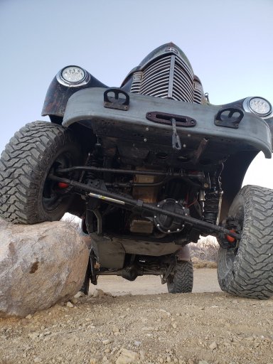

The new modifications did hold up. I hit the left and right frame extension numerous times. Also, as I figured, the added tow hitch said hello to the rocks a lot. But it all stayed where it belonged, so I am happy with it.
