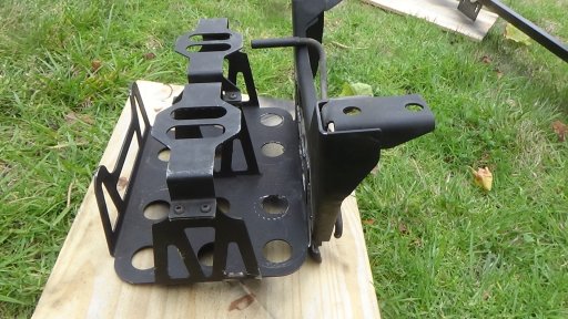

First off, the throttle linkage is done. This was a little tricky since the throttle for the om606 come underneath the air intake plenum with a 3.5" throw, while the van's throttle cable went to the right top of the engine with only a 1.5" throw. I made a linkage that bolts to the top of the om606 and comes through the back

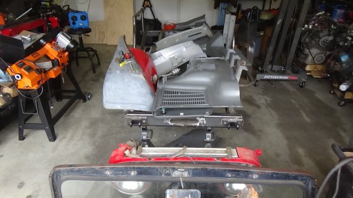

I also punched out the parts I needed to build a new front winch bumper while I was working on the throttle, but that will be a later post. The other bigger update is the body swap is done! Dad came into town and we knocked it out in about two days of work.
It'll still be a little while till she's up and running, but that's a major step done. Up next is connecting all the fuel, coolant & oil lines, replacing the steering column, rewiring the van and getting the intercooler set up. All that should get her drivable so the rest is just cleaning/redoing the interior and just buttoning up things here and there. Very excited with the progress
