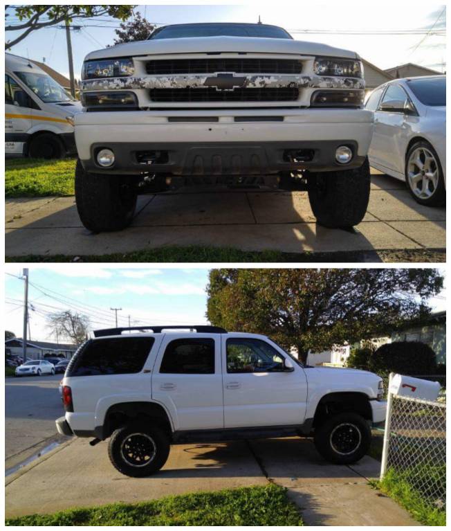

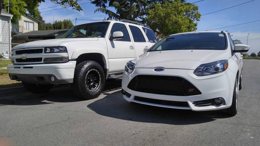

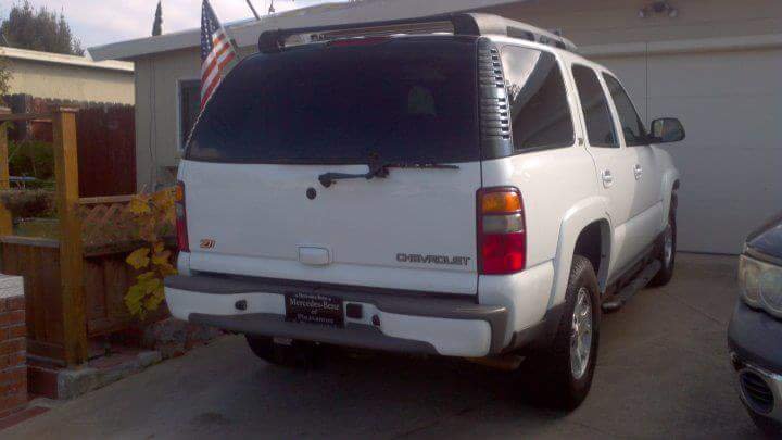

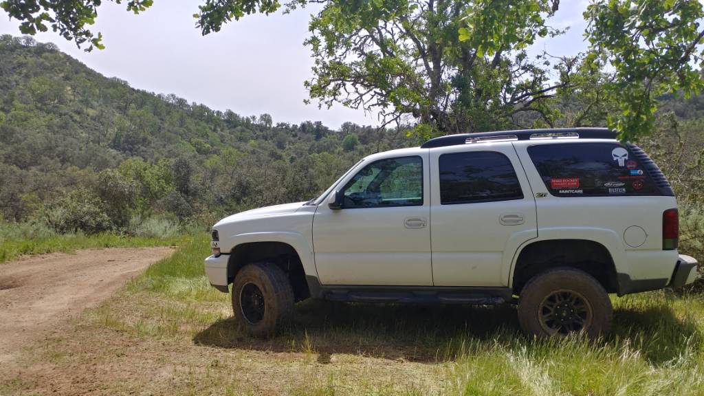

Bought it used in 2012 cause my wife was pregnant and I needed something bigger and I wanted something 4wd. I have always loved this body style and the price was right...

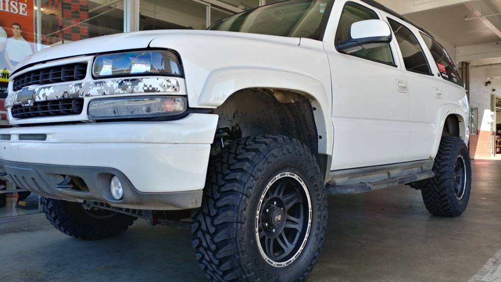

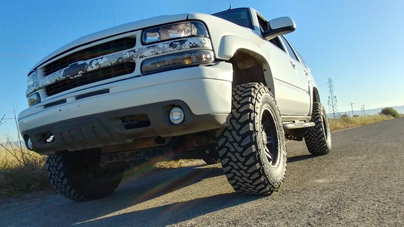

A few years went by and I did nothing to her except maintenance, fuel pump and water pump. Then the influence hit, @Jasonb "persuaded" me into a key lift and bigger tires... Here she is on a procomp key lift/spacers and 285/70/17 with new procomp wheels...

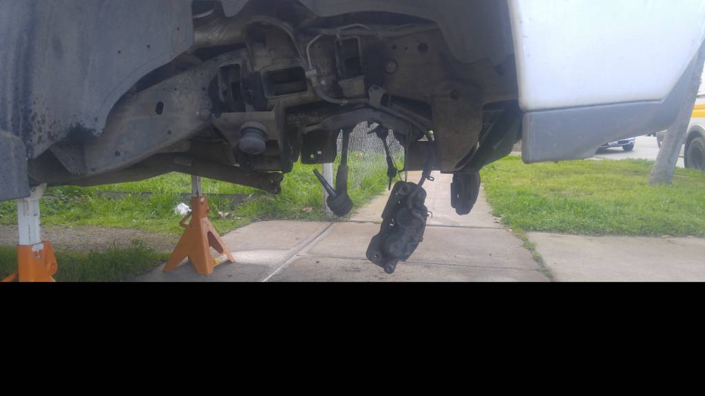

Well... Then I got "persuaded" a couple months ago when @Jasonb told me about OB and that he wanted to do the Mojave Trail next year... So now she's on a 6" RC lift and has had the entire front end rebuilt...

It does well off-road but sway bar disconnects are probably in my future...I turned the keys down close to stock cause of how rough lifted keys ride and alignment issues... I highly suggest getting the HD tie rod ends, steering stabilizer, and custom brake lines... It makes everything much tighter and doesn't stretch the lines.

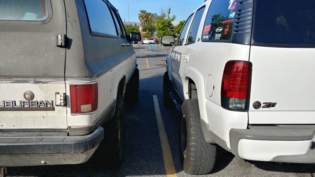

Is that the war machine next to you?

@W4P honestly my wife is pretty cool about my projects. I worked my ass off to pay down alot of debt we had (side jobs help alot too), and I just bought it. Like I said, she's pretty cool, giving her a second son helped a little I guess...
