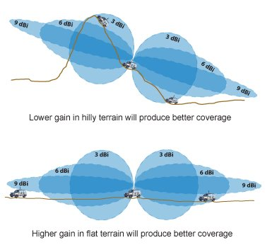

Been using Midlands and Baofengs for a while now.... If the UV5R is setup correctly it works fine with any GMRS radio.... Keeping in mind you need to "Program" the frequencies In per chanel.... Which is avaliable on the web... I use a PC app, Chirp, which works a treat.... If you buy the Baofeng GMRS specific radios they work with any other GMRS radio. In the past the Baofeng radios, specifically the UV5R variants were "Iffy" now they are as good as any other out there... The fact that you can fit another antenna makes them exceptionally appealing... even if illegal.... which you can't do on the Midland handhelds... Cause they are legal... But in the open they work well, line of sight on the better units, 10km is no issue..... What I have found on any of the radios.... Antenna instillation is key.... Do it properly and tunne it with a SWR meter, you will be surprised at the range.... Correct cable, well fitted connectors, and tuned length of antenna after the instilation Is connected and you will get maximum range.... But you won't speak through and around mountains... No radio will......
