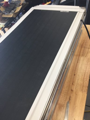

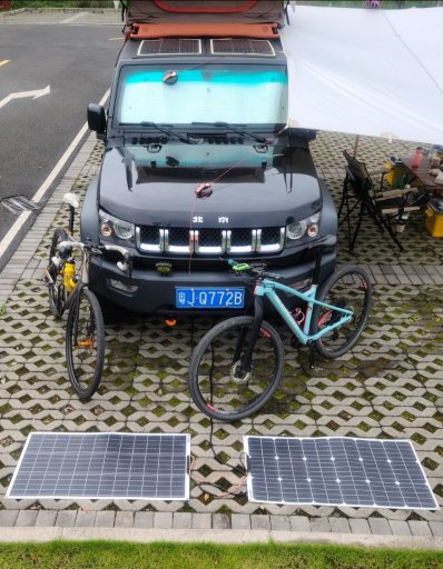

I've been running 2 flexible 50 watt panels mounted to the removable fwd roof sections. Used 3M two sided foam tape to install...going on 3 yrs now without incident. A simple plug and play setup which allows for additional "loose" panels or the removal of the actual roof sections. The 2 x 100 watt panels stowed inside, above the roll bars when not in use.
The additional 2 x 100 watt panels are stowed inside,Screenshot_20240327-083837_Gallery.jpgScreenshot_20240327-084311_Gallery.jpgScreenshot_20240327-084034_Gallery.jpg

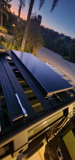

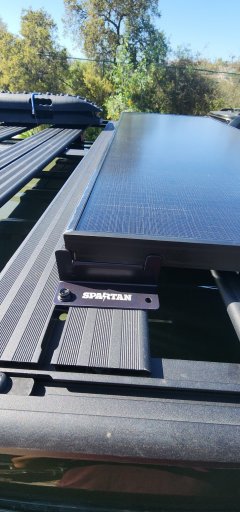

I installed a 100w panel a few days ago, only my roofrack. Sacrificed some space, but it is working great!
Waiting on an ecoflow river 2 max in the mail, but have my delta 2 hooked up, and in the past few days, it's kept my delta 2 full. I don't think I'll need to bring the 220 watt panel anymore.
The additional 2 x 100 watt panels are stowed inside,View attachment 276161View attachment 276162View attachment 276163
That's a neat setup! I normally bring my 220 watt folding panel, but mounted a 100w on my roofrack, it works great!
You can barely tell its even on the roofrack, and makes zero noise on the highway.

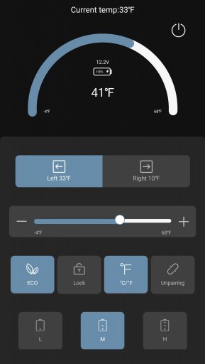

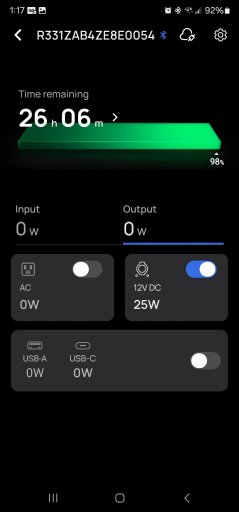

Fridge/freezer draws 50w at most, solar panel charges up to 80w. So far this week, with rain and cloudy days, the battery will be at 100% by 1 pm.
I'm really liking this setup.
Renogy 100w
Alpicool 35qt
Ecoflow river 2 max
Reactions: Sea Diamond

I see more AlpiCool fridges these days...I have the same but 30L. It's been good so far.. 2 x 5 month and 1 x 2 month full time tours.
Our 300 watts worth of panels just squeak us by during cloudy/rainy periods...and that's with modest electrical requirements other than our fridge.
Our 2 x 50w panels are good while traveling but more often than not they're shaded from our RTT or trees while camped. Where as the 2 x 100w panels are on a 30ft. extension and can be placed in the sun.

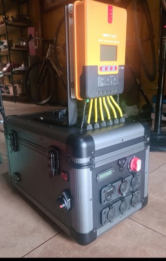

Passing onScreenshot_20240409-201840_Gallery.jpg a photo of my homemade battery box...includes a 100ah Lithium battery and mttp charge controller.
Also...because my panels are not symmetrical I need to wire in combination (parallel and series) to achieve maximum efficiency.

Passing onView attachment 276984 a photo of my homemade battery box...includes a 100ah Lithium battery and mttp charge controller.
Wow that's a really cool setup.
